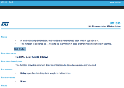

@ankhola wrote:what is the significance of "void delay (unit16_t us)" and "HAL_Delay()". .
The clue is in the names - they provide inline delays:
HAL_Delay() comes from the ST HAL firmware pack; it provides a delay in milliseconds.
It is documented in the User Manual for the firmware pack:
https://www.st.com/resource/en/user_manual/um1850-description-of-stm32f1-hal-and-lowlayer-drivers-stmicroelectronics.pdf#page=50
via: https://www.st.com/en/embedded-software/stm32cubef1.html#documentation
Note that all the HAL functions are also documented in comments in the source code:
* @brief This function provides accurate delay (in milliseconds) based
* on variable incremented.
* @note In the default implementation , SysTick timer is the source of time base.
* It is used to generate interrupts at regular time intervals where uwTick
* is incremented.
* @note ThiS function is declared as __weak to be overwritten in case of other
* implementations in user file.
* @PAram Delay specifies the delay time length, in milliseconds.
* @retval None
__weak void HAL_Delay(uint32_t Delay)
