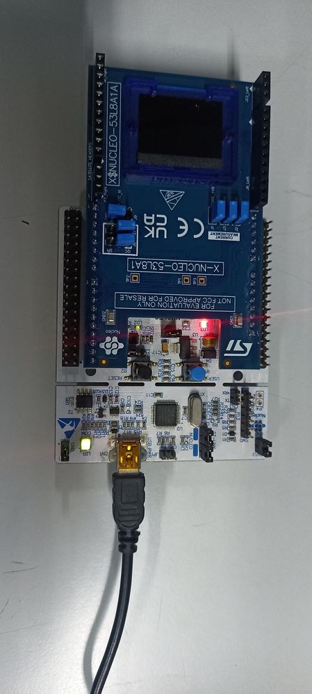

X-nucleo-VL53L8A1 not working with nucleo-f401re and GUI,
when i connect vl53l8 expansion on Nucleo-f401re ---LD1 blinks red and green...also com port shows in device manager but vl53l8 GUI does not show/detect com port

2023-04-26 5:27 AM - edited 2023-11-20 7:06 AM
Hello @Imen DAHMEN thanks for the quick response.
I have checked the schematic and the jumper setting looks fine.
PFA picture and video.

but The moment I connect vl53l8 expansion board on base board (nucleo)...LD1 keeps blinking green and red.
the same nucleo base board was working fine with vl53l5 satel board , but its not working with vl53l8 expansion board.
its strange!!

It does not work, if i connect the expansion board on nucleo f401RE board...the GUI does not display com port list on refresh,
and then after some time it flashes a message that com port closed. overall the GUI becomes unresponsive and the disk drive keeps disappearing and appearing again and again, sometime even all USB port freezes , it resumes when i disconnect usb cable from nucleo.
i have recently purchased this vl53l8 expansion board .
