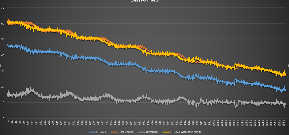

in the attachment there are the output data from two sensors.

HI @Eleon BORLINI , we have 10% failure rate in our sensors, and they failed since the beginning, we are now trying to know if we can solve this problem by adding our own Offset to the firmware, in the attachment there is the output data from a "bad" sensor.
it is obvious that the sensor is working but with a false offset.

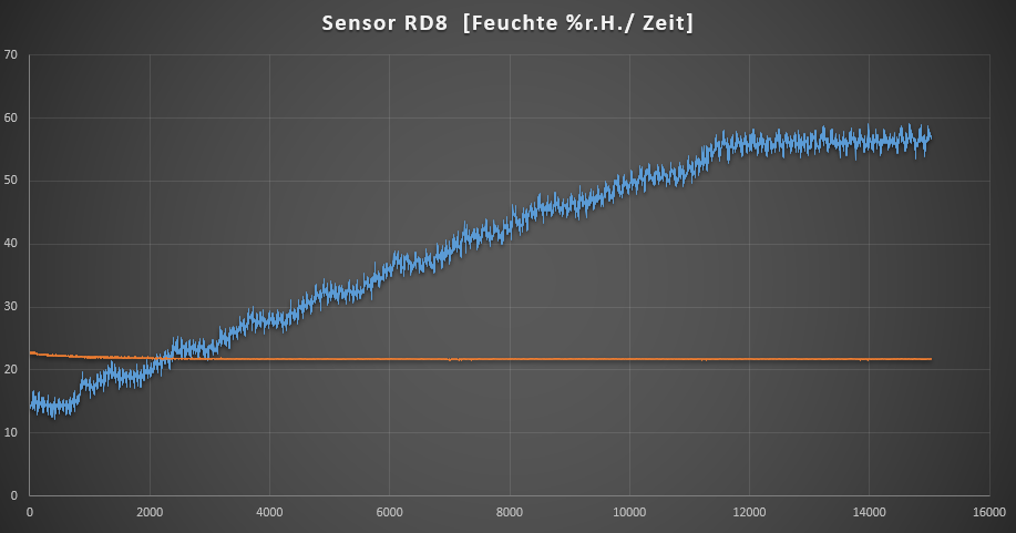

2021-06-18 7:09 AM
-Sorry I did not explain very well, this information are from bad sensor, the blue curve is the humidity, and the red is Temperatur,
We put the sensor in climate cabinet at 21°C, and a tried to increase the humidity, the sensor has reacted well but with lower result.

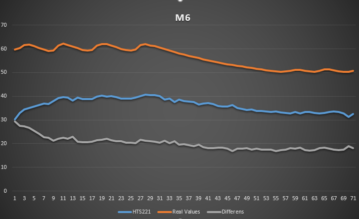

Hallo @Eleon BORLINI ,
we have just discovered that the sensors do not have the same difference so we can not solve this problem through a new offset.
in the attachment there are output from 2 sensors. the difference are obviously not the same .
