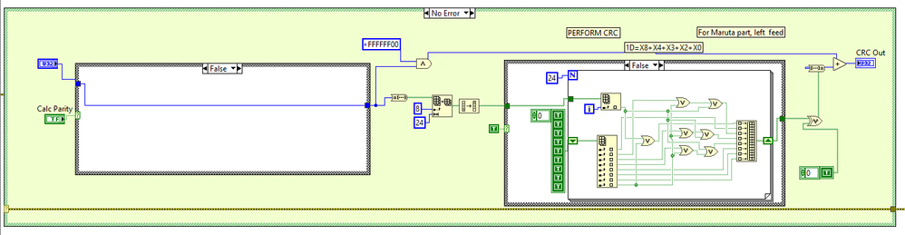

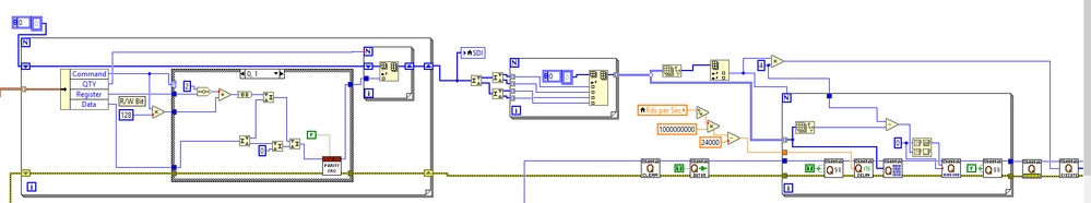

2020-08-26 3:10 AM
Hi @DDale.1 , I first would suggest you to read carefully the datasheet,
Then you may be right the chip is not as plug-and-play as almost every other ST sensor, since it is SPI over 32 bit and with polynomial CRC to check the data consistency. I may share you the screen of a labview code for the initialization of a similar chip.
Regards
