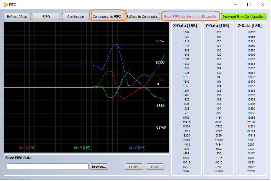

I am trying to configure a LSM6DS3 to capture Tap events in the FIFO similar to how Unico does.
i.e. I press "Continuous to FIFO" button (to enable a new capture), then tap the sensor, and the acceleration of the tap event appears on the screen (after being read from the FIFO).
0693W00000JN5aVQAT.pngI used Unico to derive my configuration. It is here in csv format:

With this configuration I expect that the FIFO will contain:
 * 32 accelerometer samples for each axis
 * contain the Tap Event
 * the timeframe immediately before the Tap Event.
I tried two different configurations (A and B)to achieve this by changing CTRL4_C, STOP_ON_FTH.
