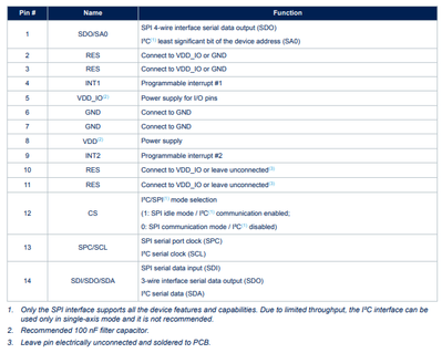

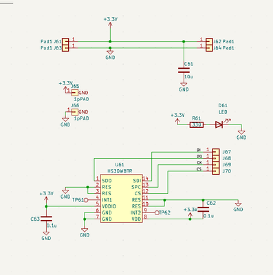

From the schematic I noticed that PIN 10 and PIN11 are connected to GND, but from our specifications, reported in the datasheet, they should be connected to VDD_IO or left unconnected. Try this and let me know if this solves.

Can you share more information about your setup? And also your schematic?
Thanks
Hi Federica,
I share my setup as bellow.

And I share my schematic of IIS2DWB test piece.
SS20231221_085314.pngThanks

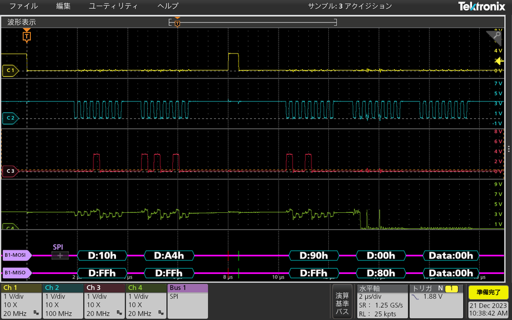

I also share my screenshot of my oscilloscope signal between mcu and the sensor.
KTanaka
Associate II
Thank you for your good answer.
It was very helpful.
I will make that correction in the next version
