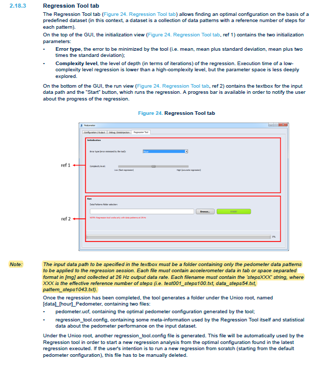

the Debug/Data injection tool works only with the ProfiMEMS board (STEVAL-MKI109V3) plugged in.
The regression tool can work also offline (without the board), and for a check about the usage of the tool I suggest you to refer to the youtube tutorial video and to the Unico user manual, in particular for the paragraph related to the data to be imported (Pedometer tool), as shown in the section highlighted in yellow:
