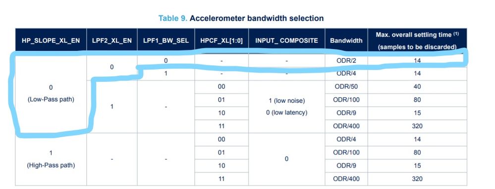

I am using only Accelerometer and have powered down Gyroscope. The settings are: ODR = 6.66KHZ, Full Scale = +-2g, Analog bandwidth filter (BW0_XL = 0) = 1.5kHz, Bandwidth = ODR/2 (As shown in the picture below)
