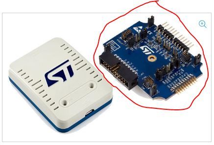

I think that the adapter board from STLINK V3 to SensorTile.box is already available now. Can you confirm that the image that I attached here is the adapter that you are talking about? It's the adapter board MB1440.
I am having a problem in flashing the FP-AI-SENSING1 on SensorTile.box. I successfuly write the file on the SensorTile.box but there is no data output on the STBLE app and after 2 minutes there is an error occured and the SensorTile.box turned off.
​Hi @Eugene Agustin​ , please note that in this moment, since STLink V3 supports only 3.3V VDD and above, while SensorTile.box runs at 1.8V, to program it, what is needed is STLink V2 with a 7x2–to-5x2 adapter to connect it to the STLink V3 physical connector (available on SensorTile.box PCB). In the (hopefully near) future, when MB 1440 level shifter will be available for the STLink V3, it’ll be natively supported by ST Link V3. Regards

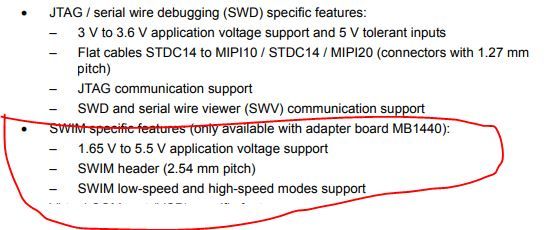

Please do confirm in reference with the manual. I attached the image cut from the manual.
Since I am using the SensorTile.Box and STLINK-V3, I am connecting the 2 devices using the JTAG/serial wire debugging with 3V to 3.6V.
I think I made a mistake that it has a 1.8V. It is thought SWIM, which I am not using for the SensorTile.Box.
Please confirm if I am correct.
With regards to STLINK-V2 there is 2 types of it. which one should I use? STLINK-V2 standard or the STLINK-V2 ISOL?
Thank you.
​HI @Eugene Agustin​ , yes you are right. The SWIM interface is the communication protocol for the STM8 MCU family debug, while the JTAG/SWD is dedicated to the STM32 family, which is the one of the SensorTile.box. The tool mounts an STM32L4 supplied at 1.8V for low power reason (being an IoT module), but this is not compatible with the debug supply at 3.3V. The upgraded circuit for the STLINK-V3 should be soon ready, but for now it's better to use the STLINK-V2. I suggest you the STLINK-V2 standard with a 7x2–to-5x2 adapter to connect it to the STLink V3 physical connector (available on SensorTile.box PCB). Regards
