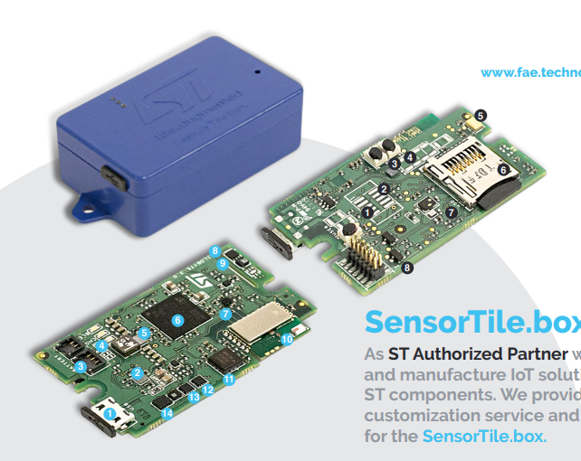

Hi @Eugene Agustin​ , if programming through JTAG/serial wire debugging (SWD), I suggest you to use the ST-LINK/V2 programmer because of 1.8V level compatibility with ,ow power STM32L4R9. The HW connection is the connector numbered "8". Board schematic will be available soon on st.com. Regards

Unfortunately no pictures of the back side of the board.
Suggest you contact your local sales office and discuss.
Eugene Agustin
Associate II
Here is the back side of the board.
Please look at the attached image thank you
No picture attached. Make sure you upload and insert it.
Eugene Agustin
Associate II
Sorry I forgot to insert.
