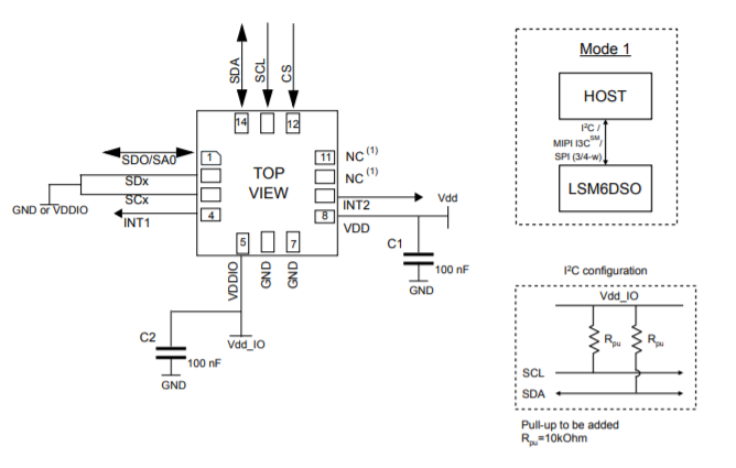

I'm wondering if it could be related to an hardware issue, i.e. to some interferences on the I2C lines.
Are you using a custom design? If so, did you follow the recommendation that you can find in the datasheet, p. 35?
Also, do you have the possibility to test another part? Maybe the one currently under test was damaged during the operation (you might check it by measuring its current consumption).
