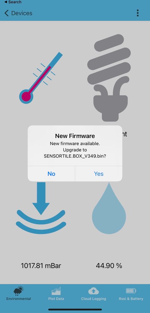

we have a sensortile that I connected to via the sensor ios app. got a pop up in the app that there's a new firmware available. and pressed ok. following that, the board did not come live. the same thing happened on a second board.
2021-10-06 4:20 PM
this is the firmware that crashed now 3rd sensortile.box immediately after the update.
