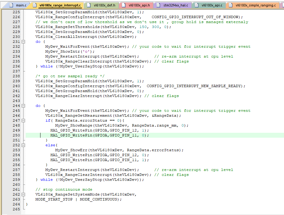

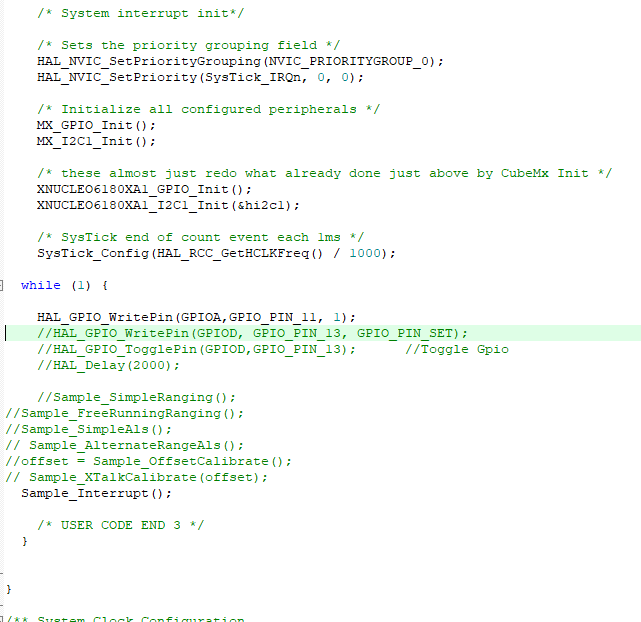

Yes I've found the solution thanks evryone for helping me.
I sent you an example of my main code and my interrupt code. I've just take another pin of the MCU to command the LED it was very simple when my MCU detect the interruption my LED blink but I've add another LED who should take on when no target is detected and off when target is detected. Sorry for my english i'm french.
In the bottom you will see the code. Thank you

Hello @Eleon BORLINI
2020-09-17 8:28 AM
Good job @MSAMB.1 !
-Eleon
