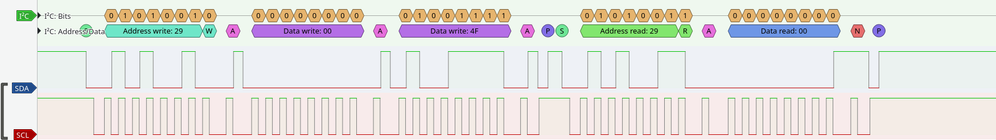

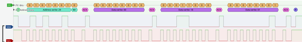

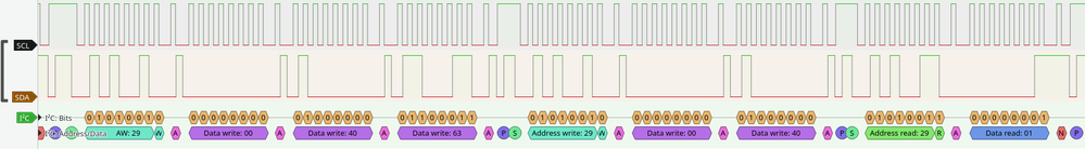

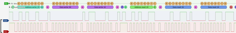

My I2C communication seem to be more or less OK.setting 0x0018 register
reading 0x004f register
reading 0x0062..63 registers
Unfortunately the attiny85 USI interface is a bit sloppy with I2C timings, but it seems to be doing the job OK (I think it would have been better if SDA was delayed by ~2uS, but I do not have control over that, unless I rewrite I2C with pure bit banging implementation). BTW I run my attiny85 at 8MHz with 1/1 clock division (I could not go over 50kHz I2C rate otherwise).
