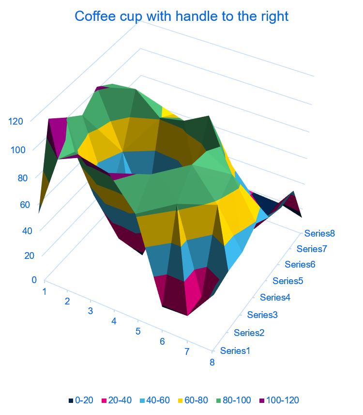

The picture below was taken with one.
It gives you a 8x8 image, 15 times per second.
Here the sensor is looing down into a coffee cup, with the handle on the right.
The VL53L5CX costs a bit more than the VL53L1, but it's still not very expensive.
And you get a LOT more.
So if you can wait until late June you will be all set.

The VL53L5CX - due out in June (probably the last day in June, though) is what you want.

Well you get 2 points for getting the math right :) 43 degrees on a side is correct.
As the sensor does 8x8 you get 43/8 or about a 5 degree area.
Now you might see something that only covers only 1% of that area. Is the object particularly reflective? Or does it have a reflectivity that is clearly different from the surface on which it sits?
You don't actually have to get an exact distance to know something is there - the distance just has to be different from when the object is NOT there. And you can double check it if the reflectivity changes.
In the graph above the rim of the coffee cup was only 5mm, but the edge is clearly visable.
The good thing about ST sensors, is that you can buy an evaluation kit. Generally these are about $50. In 20 minutes you can take enough data to decide if the project is worth doing. It's a few dollars well spent.
