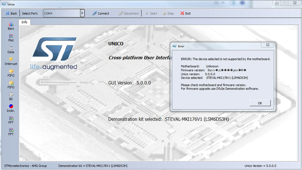

Thank you for the response Miroslav. The reason I downloaded version 2 was that it was on the downl;oad page for the STEVAL-MKI176V1. I have downloaded version 5 now.
I am trying to communicate with the Gyroscope over SPI on the LSM6DS3 device on the
STEVAL-MKI176V1 via the STM32F103 microcontroller.
When I try to connect to the device using the GUI, I get the error attached. The firmware version isn't being recognised. The motherboard that I am using is a custom printed board.
Regards,
cod

Unico and Unico Lite are intended to work with eMotion board (
) or Professional MEMS tool ().You can connect all sensors available in DIL24 adapter like LSM6DS3 (
STEVAL-MKI176V1).
Please be aware you have to upgrate the firmware in the board by the one distributed together with Unico.
If you use your own board custom board you would have to write your own firmware compatible with Unico, which is very difficult.
I would recommend you to send the data from your board only to terminal.We’re moving the ST Community to a new platform to give you a better and more reliable community experience.
