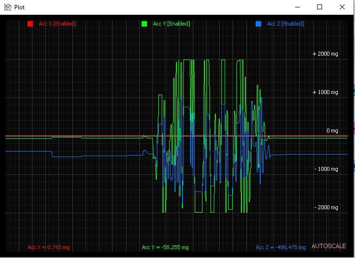

What I see on the plots - no movement on X-axis, no matter how much I shook it.

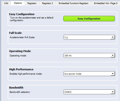

Controls are set to "Easy Configuration"

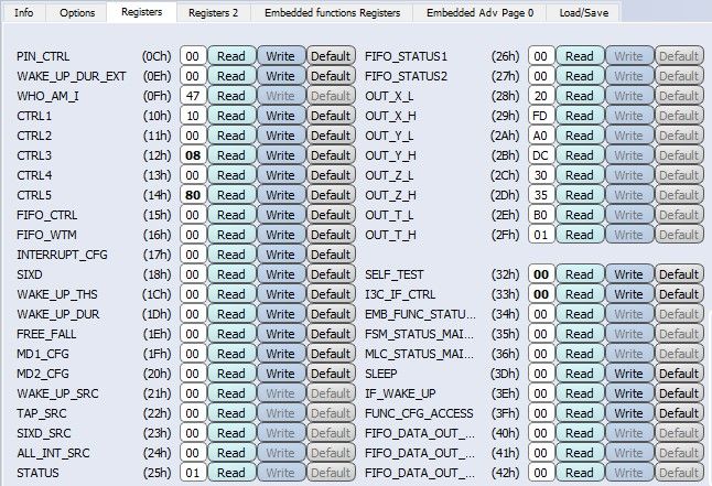

Register settings and readouts.

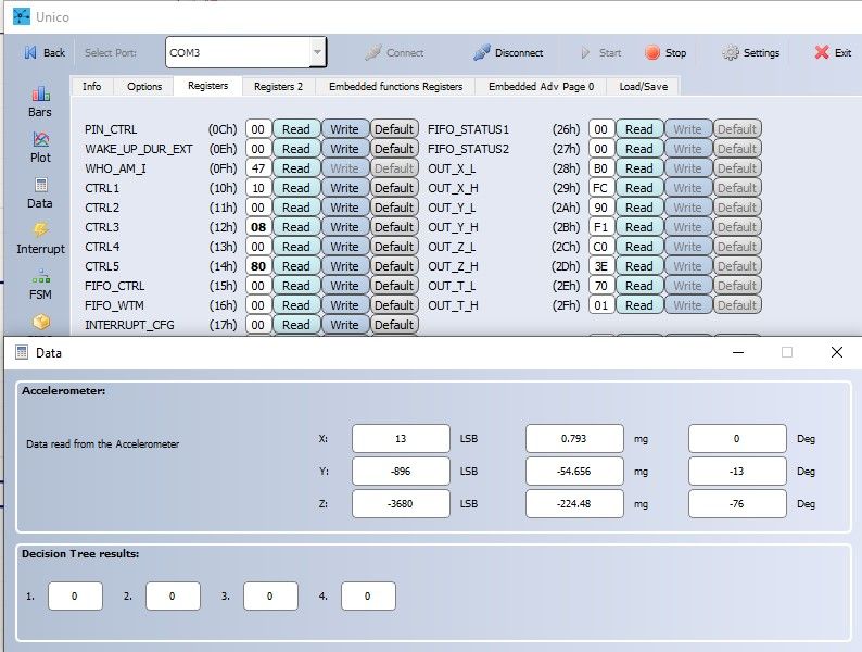

Comparing OUT_X/Y/Z registers and what Unico displays. X_OUT was 0xFCB0 = -848, which was close to 'Y', and Y_OUT was 0xF190 = -3696, which was close to 'Z'. I couldn't tell where the "X=13" came from, and it never moved.
