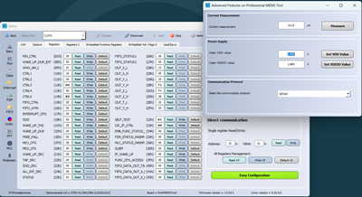

This is an image of the consumption before changing the register value:
And this is the after:
There is a clear improvement of the consumption but still a bit out of the 10.8 uA claimed in the datasheet. Is this something expected due hardware limitations or am I need to disable something else?

Federica Bossi
Hi @sch0bert ,
Note that the value reported in the datasheet is a typical value so some oscillation are allowed.
The new AN version will be published within next week :)
