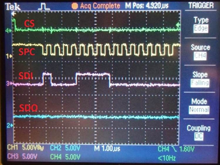

I have the problem with LIS3DH in SPI mode too.
Whichever register I try to read, the answer of LIS3DH is 0xFF. The line SDO is everytime in high state.Here is a picture with try to read register WHO_AM_I on adress 0x0FWhat am i do wrong ?2013-10-02 11:28 PM
The problem was in bed soldering of IC. The same way on two board, that led me astray.
