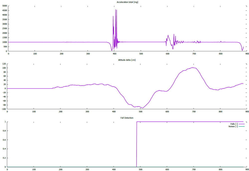

Indeed, to simulate the fall can by quite tricky.
I will explain a method which work for us:
- Wrap the board into some foam to avoid a damage when the board hit the ground
- Hold the board in vertical position (USB connector down)
- Drop the board
- Let the board still on the ground for a while
To evaluate the impact as man fall the altitude must change about ~80cm, the impact should be higher than 3-4g and the board must remain still after the impact.
Here is one example of fall detection:

Hmm. Wrapped it in bubble wrap. Dropped it from 4 feet to ground. Ive watched the user events, as well as looking at the fall detect screen. Ive also simply put it in debug mode from workbench, and waited to see the falldetect change state. Have yet to see it trigger. Any thing I have to do?
2017-10-13 7:11 AM
You can have a look at this
showing our test.I would be also good to record the acceleration and pressure and check them offline.
