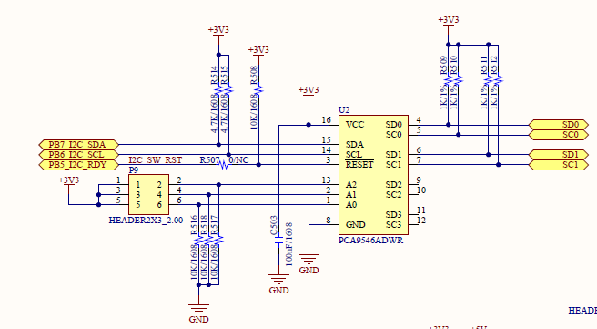

I'm trying to get the sensor value with stm32
Maybe because I connected the board to one i2c and attached two sensors, the value didn't change

Humidity sensors are connected to SD0, SC1 via i2c

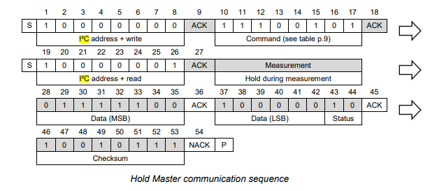

0xE5 doesn't seem like it can be a valid address.
It's a measurement command (Temperature) for the read.

Take an oscilloscope (not a logic analyser guys) and observe the i2c bus. Monitor the slave address ack bit.

The code doesn't appear to provide the 7 to 50 msec Hold during measurement. See page 5 of the data sheet.
(Edit) You might try asking for example code as stated on data sheet page 10. The data sheet date is 9 years ago, so there may be no response.
