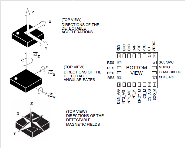

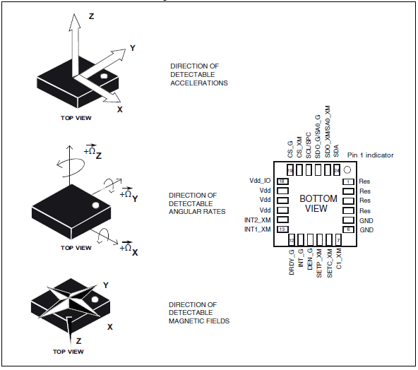

Yes, the orientation is different.
LSM9DS0
LSM9DS1
You also have to do at least hard iron calibration of the magnetometer.

I did look at that. The Pin 1 indicator is also in a different position in the images which makes it hard to work out what has changed.

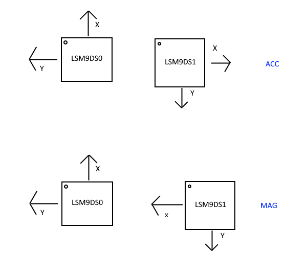

I quickly put the image together below, showing the difference between LSM9DS0 and LSM9DS1.
My assumption is that when looking at the images from the documentation, the side where the letter is ( X,Y,Z) will give a positive value if rotated in that direction. And Z is flipped for the MAG.
