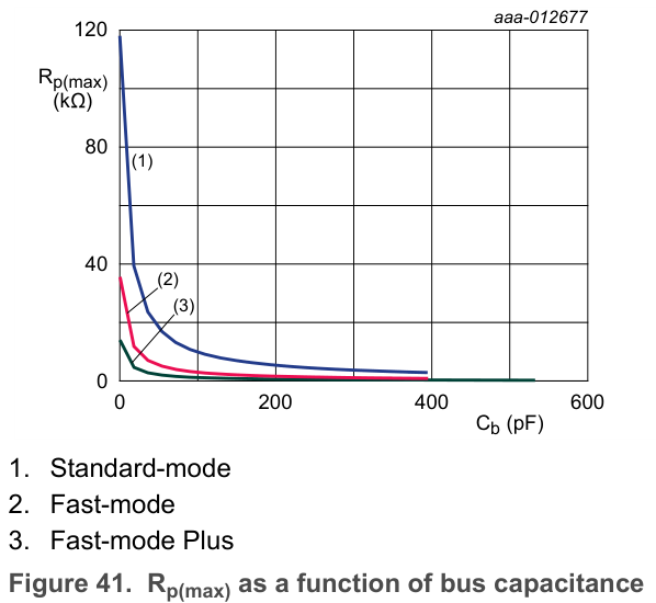

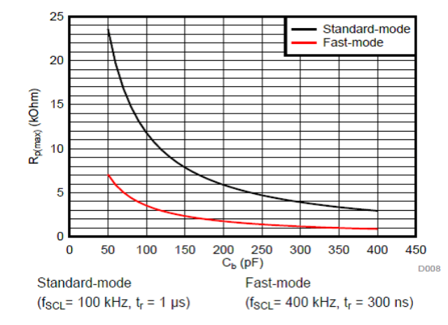

I meant, might need a *lower* pull-up resistance value for 400 kHz. (Apologies if the expression was ambiguous)
Like the SO's answer in your reply, the exact need resistance value is very different for each bus design. especially bus capacitance.
According to the documentation of the NXP, the 10 kOhm covers a very limited capacitance area:
this is the Maximum pull-up resistance value vs. Bus Capacitance value by TI (SLVA689). When it is 10 kOhm, there is no Fast-Mode section (in my opinion, TI seems to reflect the real world a little more...):
as mentioned earlier, the this graph is not an absolutly result. however, the issue between the pull-up resistance and capacitance of the I2C bus is a frequent occurrence. (especially if there are multiple units on a single bus) waveform measurements will be required for accurate solution.
but this is just speculation as well, need more information for a clear diagnosis...
