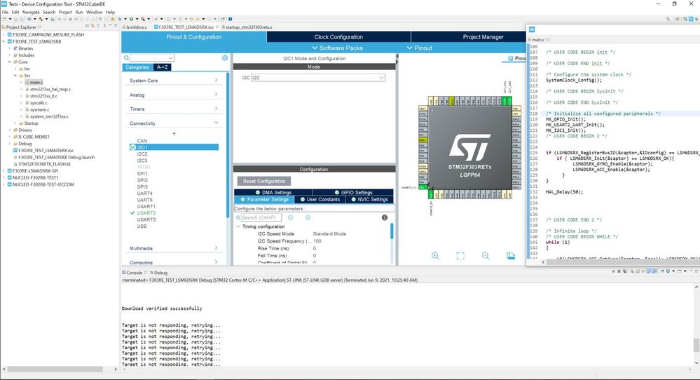

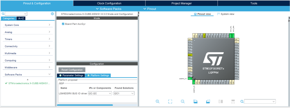

I am currently working on a STM32F303RE wired to a STEVAL-MKI195v1 throught a nucleo-iks01a2. When I tick the box corresponding to the mems package I use for data-retrieving from the lsm6dsrx on the STEVAL-MKI195v1 board. It does not add some code generating an i2c handle nor it initialise the i2c communication protocol. But when I don't tick the box and then can't use the provided lsm6dsrx.c and lsm6dsrx_reg.c and corresponding files .h.
If someone knows a solution to this problem or could tell me where my I2C protocol is initialized it would be of great help. I joined a screenshot to give a bit of context if needed.

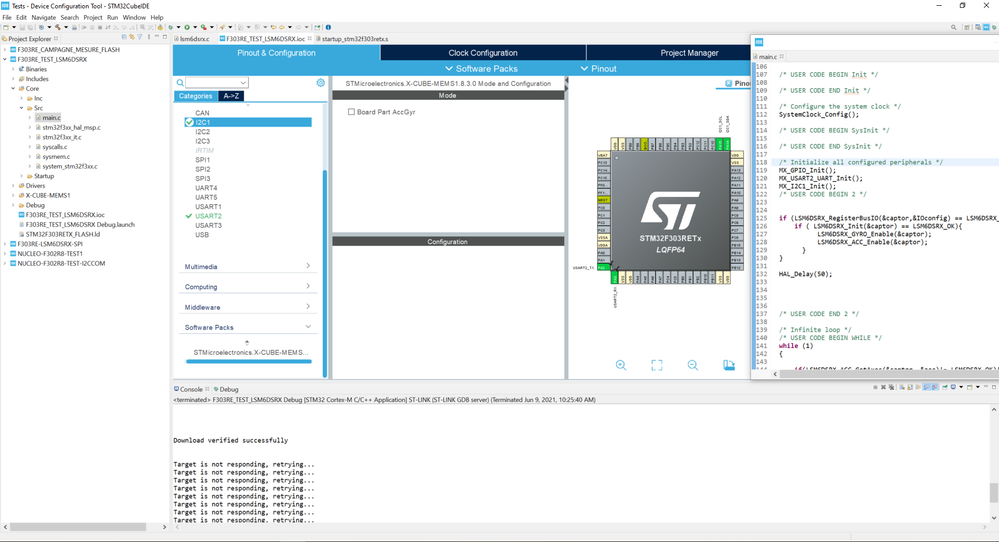

@Loïc ARBEZ I'm able to face the same. Sounds like a bug because finally being able to achieve my goal but sounds weird.
1) Based on attached .ioc file as code generation result I'm getting <=> I2C1 init is lacking !!!
I2C1 setup is

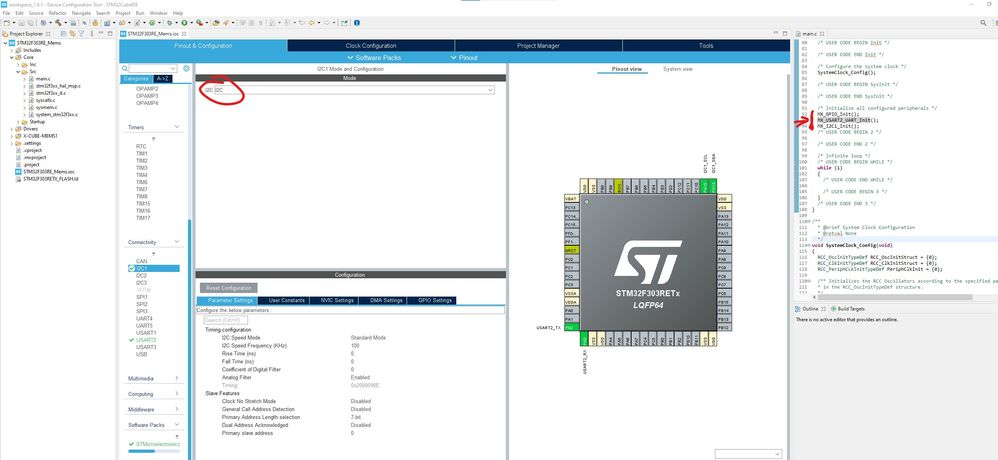

2) If I'm moving I2C1 setup to
Then ask for code generation some I2C init is happening !

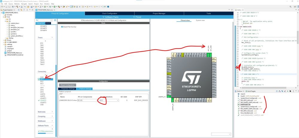

3) Let's come back to my expected setup
Then ask for code generation finally I'm able to get my expected I2C init !!!!!!

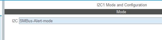

Enabling I2C1 and I2C2, only I2C2 will show up in CubeMX's 'Generated Function Calls' list. But then set I2C1 to SMBus it shows up. Set it back to I2C and the entry in the list remains.

when you use the CMSIS pack of the MEMS, the MX_I2C1_Init() is located in the file stm32zzyyxx_nucleo_bus.c and not in the main.c.
