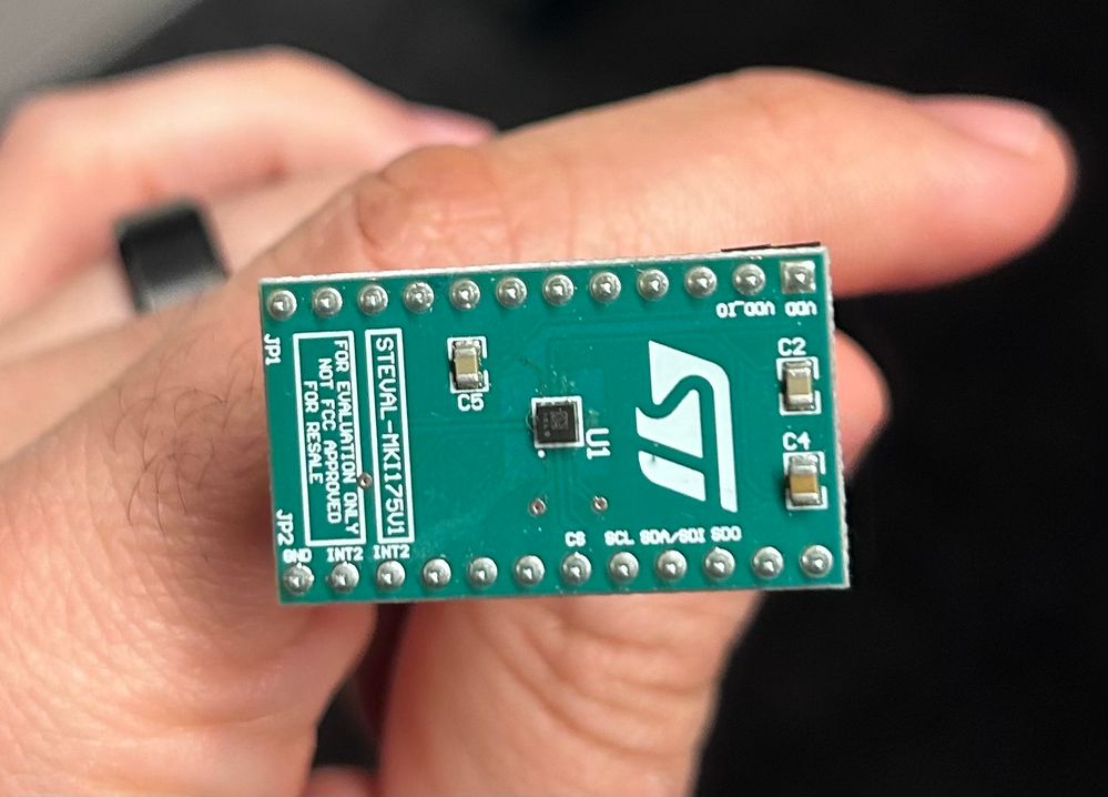

I noticed that INT2 is repeated in 2 pins so it confuses to identify which is INT1 and INT2. Please consider change it for future production.
Regards,
Pascal.
2023-12-04 7:09 AM
Yes. The datasheet says JP2 pin 14 is INT1 and 15 is INT2. The printing on the top silk needs a correction.
