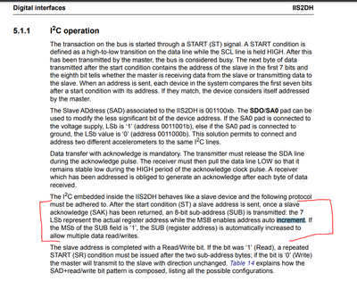

2023-08-16 5:21 AM
Hi @engineer42 ,
The IIS2DH supports auto increment on I2C, but, as mentioned in datasheet, the auto increment is based on the MSB bit of the subaddress:
If this helps you, please mark my answer as "Best Answer" by clicking on the "Accept as Solution" button, this can be helpful for Community users to find this solution faster.
