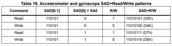

The acceleration and gyroscope SAD+R/W imu address to read in a register are 0xD5 and 0xD7. Can I choose indifferent between them and why two type of address? Have I connect any physical pin (Pin 22 SDO) to GND or Vdd?
Yes, you can choose the two of them indifferently, by connecting the SDO pin either to GND (resulting in the I2C address 0xD5), or to Vdd (resulting in the I2C address 0xD7). In this way, if you have two sensors on your application board, you can connect them to the same I2C (SDA and SCL) lines, since they will have different I2C addresses. See also the datasheet, p.30.
