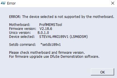

0690X000008BX39QAG.jpgmaybe it will help.
