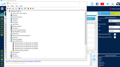

2023-10-11 2:01 PM - edited 2023-10-11 2:06 PM
Hello @Eleon BORLINI ,
I followed the tutorial, but I still don't see the ST Virtual Port in the device manager. So, I get an error message which says "the adapter has not been recognized" in UNICO.
