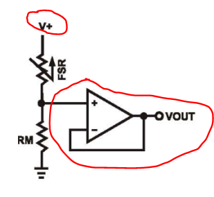

使用�?��?��?�る圧力センサー�?��?Interlink Electronics FSR X 406 �?��?�。
BlueTile�?�4c.GND, 4d.ADC�?ート�?�直接�?�ん�?�付�?��?��?�使用�?��?��?��?��?�。
  https://www.interlinkelectronics.com/fsr-x-400電圧�?�情報を�?��?��?��??�?�り�?��?��?��?��?��?��?��?�。
FSR X 406�?�Integration Guide�?�よる�?��?
オペアンプを利用�?��?�Additional FSR Current-to-Voltage Converter回路�?��?�り�?��?��?��?��?��?
STMicroelectronics LM358Nを追加�?��?��?��?��?�。
Hi @ROnod.1​ ,
I'm not an expert of this force sensor, but I agree with you that you might need an additional circuitry to make it working, properly managing the supply (e.g. 5V if compatible with the BlueTile) and the output, as described in the datasheet.
-Eleon
