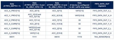

Hi @lexpart
Please note that when reading from FIFO instead of OUT_AH_BIO_L (2Eh) and OUT_AH_BIO_H (2Fh), the behavior can differ. In cases where the device is configured to vAFE only state, the output from the analog hub / vAFE is stored as a 16-bit value. Changing the configuration may alter the data assembly format representation. For detailed information on the assembly differences across various configurations, please refer to section 7.4 "Main Sensors" in AN6160.

Hello @casadeib ,
I am familiar with the document and table that you referenced. Regarding the AH/vAFE only state, all the doc shows is a 16-bit value, with no explanation for what to expect based on HP_EN. Do you have any technical information for how the 12-bit and 14-bit modes are converted to 16 bits in the FIFO? Is the resolution of the data in the FIFO also 1311 LSB/mV?

Hi @lexpart ,
The FIFO allocates 16 bits for the vAFE data, while the actual vAFE data is 14 bits or 12 bits depending on the ODR. In vafe only mode, the data in FIFO is saved as: 12 bits at 3200 Hz, 14 bits at 800 Hz, depending on your HP_EN selection and always left justified. Resolution stays the same as declared before: 1311 LSB/mV (PGA gain = 16, 16 bits, input referred).
