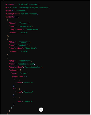

I wanted to go further and add custom parameters using ADD CUSTOM DTDL ENTRY. Firstly, I can't find the document resources describing the properites in *.json format. The example one I found, doesn't work either. I used Azure IoT to generate model but adding it failed as well.

Ciao Marcin,
you have done one question with one answer that it's not simple at all...
this is one of most complicated thing that I could explain for our system...

You need not only to create a custom DTMI entry... but you need also to create a custom FW db entry for your fw, in order that the ST BLE Sensor application, reading your boardID and FwId during the BLE Advertising will be able to recognize you and take the right DTMI that you want to use...
for taking one example of this custom Fw db entry...
you could take the Projects/STWIN.box/Applications/BLEGPEx example always on FP-SNS-STBOX1 package
That contains one example of this custom Fw db entry
https://github.com/STMicroelectronics/fp-sns-stbox1/blob/main/Projects/STWIN.box/Applications/BLEGPEx/STWINBoxBLEGPEx.json
in this file...
At the beginning there are written the board ID and the Fw ID that you must also use on ble advertise
"ble_dev_id": "0x0E",
"ble_fw_id": "0xFF",
the ble_dev_id is the device id for your board...
ble_fw_id = 0xFF is mandatory... we accept only custom fw db entry that have this fw id = 0xFF
inside this .json you must write that you want to use your custom DTMI ...
so you must add one field to it
"dtmi": "dtmi:appconfig:xxxxxxx;1",
in this way this dtmi don't point to a real dtmi present here:
https://github.com/STMicroelectronics/appconfig/tree/release/dtmi/appconfig and the application will use the one that you have load with the custom DTMI entry...
