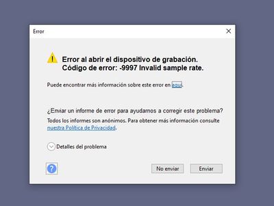

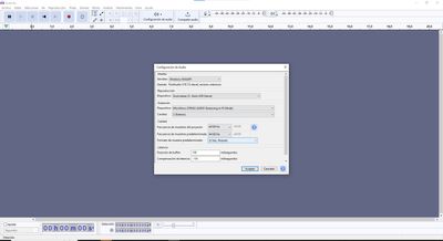

2023-08-21 3:27 AM
what happens for which I flashed the .bin on the board and then used the STCube, is because at first I tried to see if it worked, when connected to the PC it recognizes the board as a microphone, but I try to make audio recordings and it does not capture no sound (perhaps the STEVAL-STWINMAV1 is not working correctly), plus something strange that has always happened to me is that, unlike the SensorTileBox, when I connect the SnesorTile to the PC, the folder with the data that has been saved does not appear.
2023-08-21 3:33 AM - edited 2023-08-21 3:52 AM
The problem is that it is recording audio from the SensorTile mic, but it is not recording from the mic array.

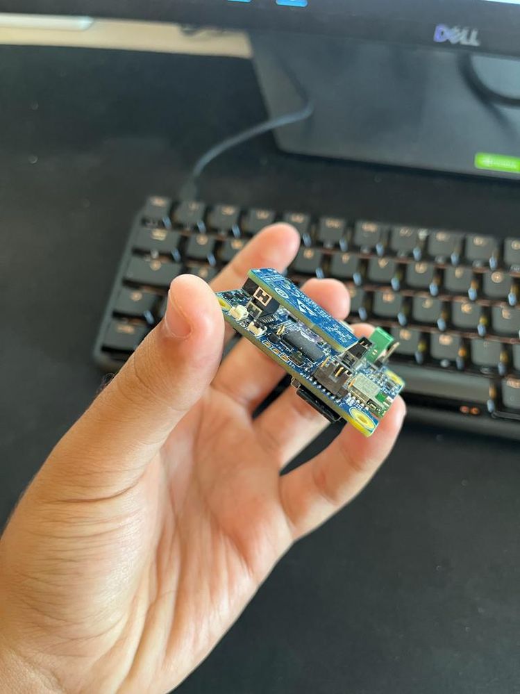

Hi @SAbba.1 ,
so now you are managing to record audio, the problem is that it's not from the mic array, right?
in this case, can you confirm that the connections are right?
(maybe post a photo of the setup)
Niccolò
