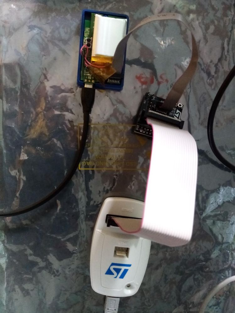

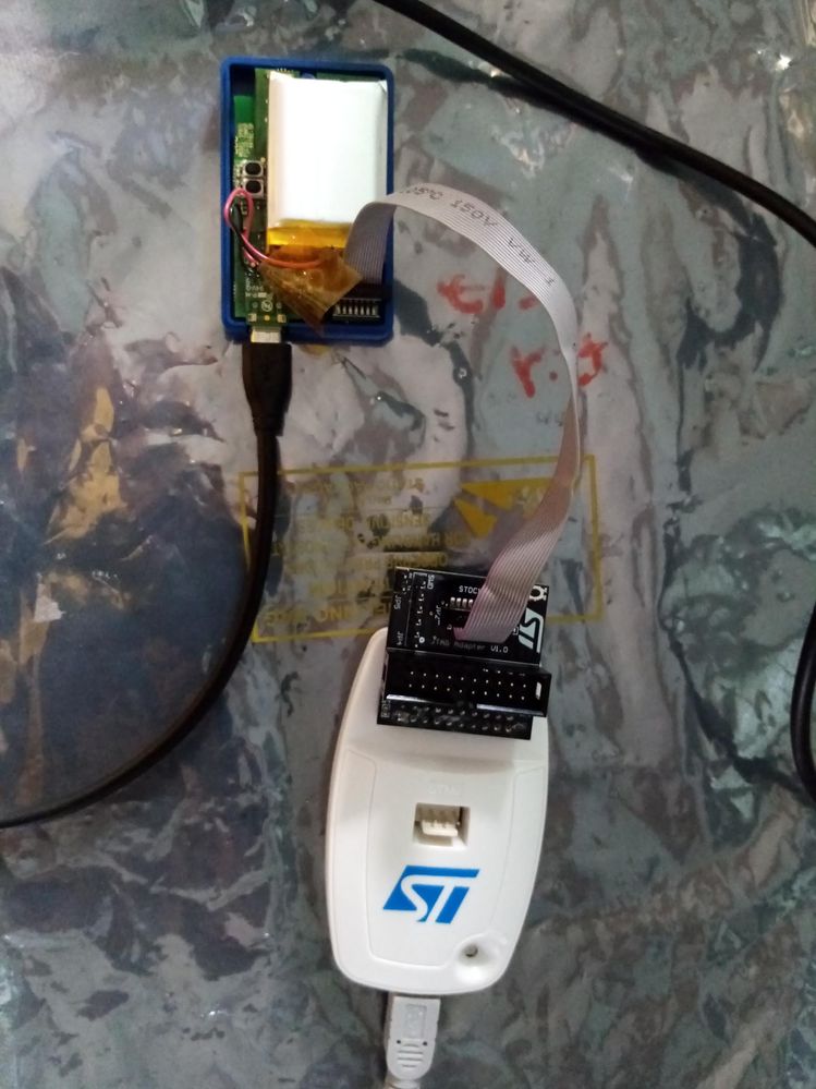

I have attached 2 images for ref. Please confirm which connections are correct.
Image 1- I have connected the St-Link with Jtag in the Adapter.
Image 2- I have attached the adapter directly into the St-Link.

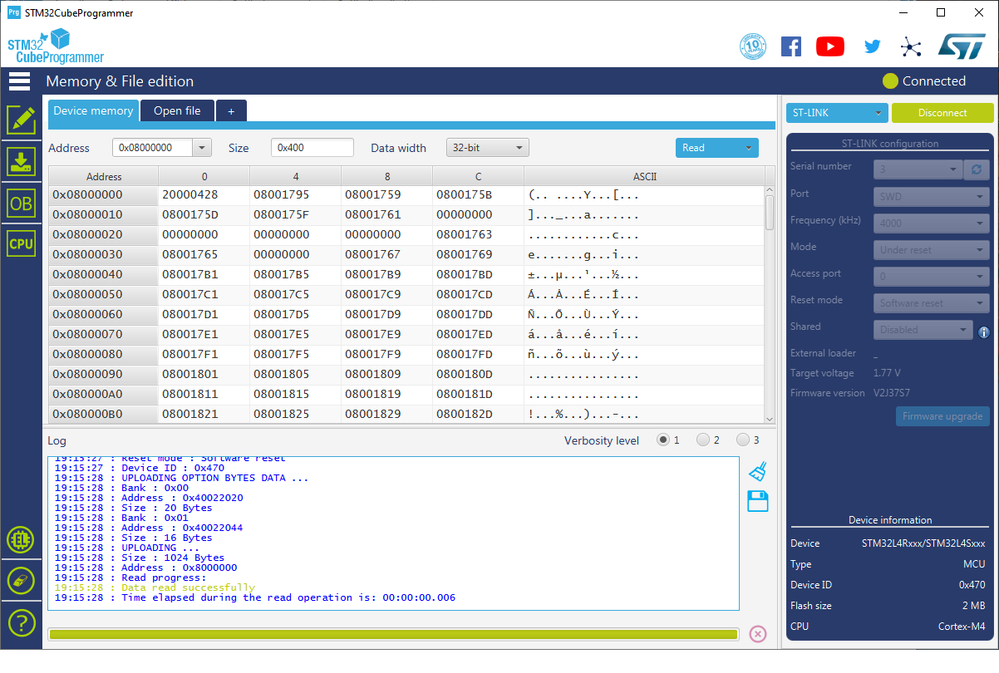

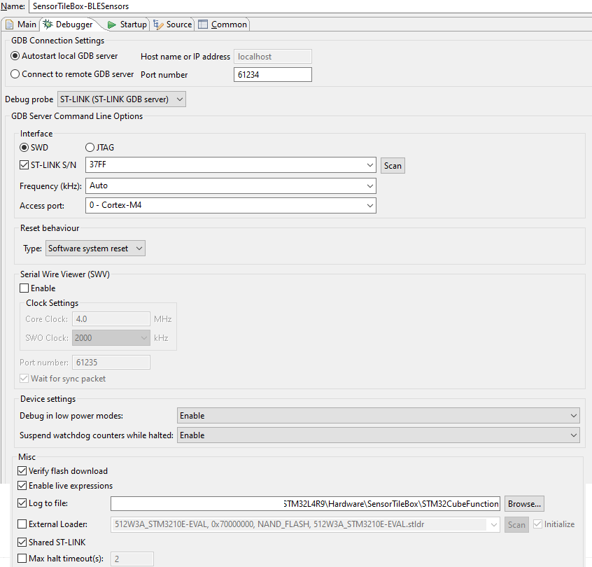

Hi, two screens shots to be shared for an IDE setup and CubeProg. Please check.
