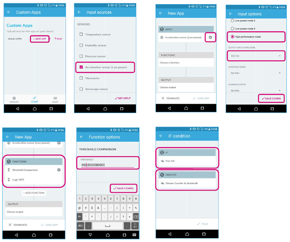

Now it's time to create your own app in Expert View (Mode 2). This mode allows the creation of custom app by allowing the user to select one or more input source available. These functions can be configured and optimized for each use case.
In addition, the ST BLE Sensor App also allows you to define specific conditions and actions based on the different functions implemented within the algorithm. For example, when implementing a free-fall detection, the app can count the number of detected events
The mobile application will then plot and count the number of events detected and data logging can also be enabled in this mode for further data analysis.
And, finally, LED toggle upon the detection of that specific event 8)
