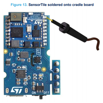

Any known issues with soldering a STLKT01V1 (sensor tile ) to the small carrier board?
I did this, and now it does not work (no jtag) it worked prior with large board
I do not want to destroy a 3rd board!

Hi, do you refer to this action?
I suggest you to center the SensorTile fixing it on the STLCR01V1 cradle main component with e.g. tape or a clip, put flux on the exposed pads and then solder the structure. Please use flux and an appropriate welder ;)
Please check also the presence of any short due to the soldering process.
Regards

yes
