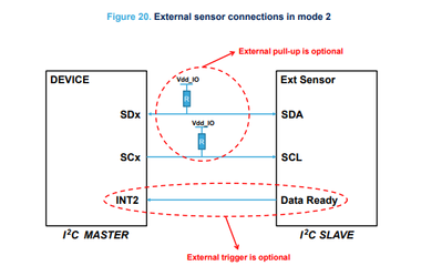

Hi @rbmarcus ,
Your hardware configuration seems correct, but ensure that there are pull-up resistors on the I2C lines (SCL and SDA). Please refer to the section 7 of AN6016 where the sensor hub mode is well described:
2025-01-30 9:18 AM
Hello @Federica Bossi,
I tested the internal pull-ups for the LSM6DSV32X, and separately I tested the system with external 4.7kOhm pull ups on the I2C lines, but in both cases the outcome is the same. From the logic analyzer readout, I can confirm that the pull ups are working properly and keeping the lines high when idle.
