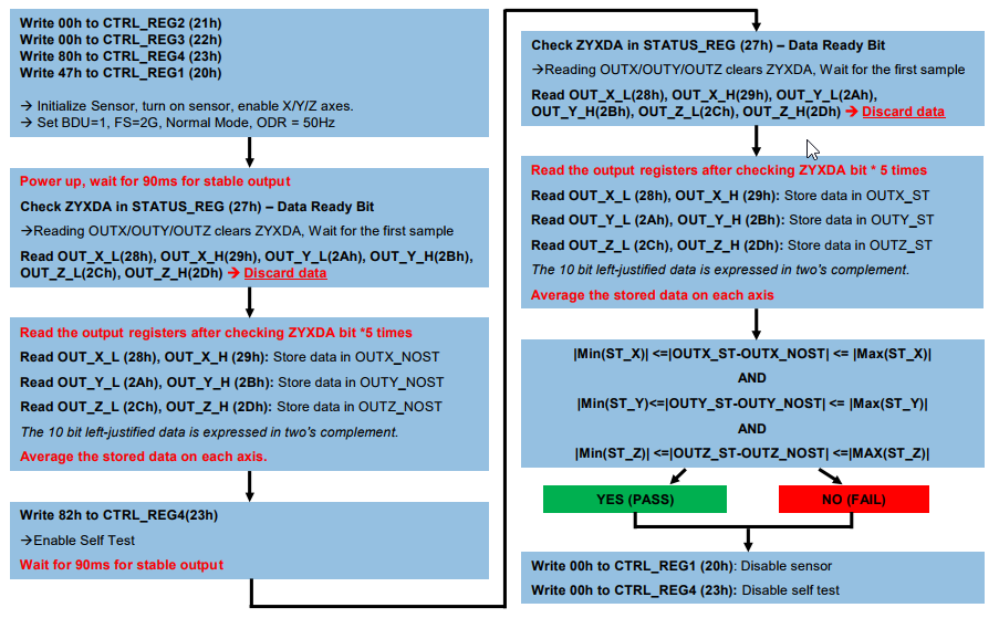

OK, I though I will check the self-test procedure directly in C code (or other language), anyway there could be a problem with timing.
Could you please update the procedure according to following flow (it is for similar sensor so you should discard two samples as it is written in the datasheet). The import is to enable BDU, wait some time after the sensor is power up and when self-test is enabled, check data ready before reading data from output registers.
