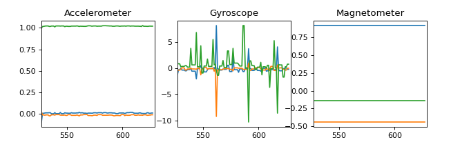

In my test board, data from accelerometer and magnetometer are stable.
But gyro data has many spikes even though it is put in desk and not moving.
Do you have any idea for what cause this and how to fix it?

Hi @Community member ,
which is, first, the unit of measure of the Gyroscope (on the graph y axis)? And which is the Gyro configuration (Mode, ODR, FS...)
If the it were milli-dps, it's a good result, since the sensitivity is 4.375 mdsp/LSB for FS = 250dps, from the datasheet, p9.
If it were dps, these could be a little high values considering that the typ ZRL is ±1dps. Are you sure you are not picking the table on which your device is, for any reason? The gyroscope is very sensible to little shocks, that may not be perceived by the human being.

2020-11-25 4:21 PM
Gyroscope Y axis means mdps.
Gyro is configured like below
Time to time, Spikes get bigger(more than +-100mdps).
In my SW, sleep mode is configured too.
After replacing one function, problem is fixed.
I guess that Power down and ODR OFF might be same. Is there a difference?
