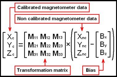

Note that there is a x0.1 factor applied before displaying those data. They are the direct output of the magnetometer (in mG) *0.1 after hard iron calibration.
Hope this will help.
Would you know if this is soft iron error how i could compensate it? I found some hints on internet but i don't know what values i should use.
