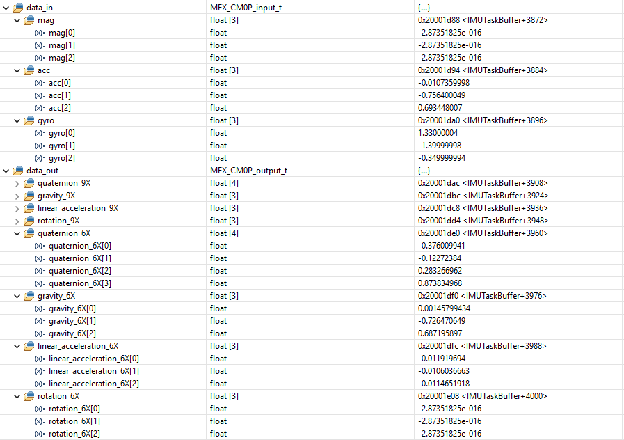

Hello wonderfull STM community,
Really enjoying the experience with MotionFX so far, really easy to implement and get working, well done ST! Even on a G0 in CM0+ mode its working well! I'm just woudring three things:
Note that mag is just uninitialized, the values are those of what was already in memory, I should fix that, through this is the first I've noticed it.
Thanks and happy coding!
