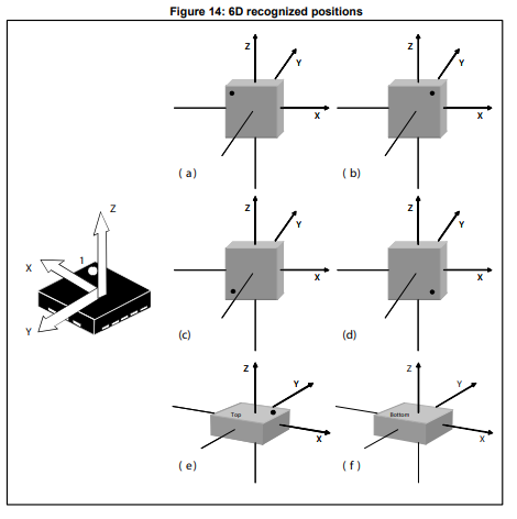

You're welcome, @gb00 . What I suggest you is to use the 4D/6D (INT1_CFG (30h) register for the setting, INT1_SRC (31h) for the polling). You will be able to detect the following positions:
Do this embedded feature match you purpose? Regards
2019-07-05 8:41 AM
Hi, Thanks for reply. Actually I want to detect acceleration w r t left, right and front (+Ve acceleration) and back( -ve Acceleration). Not position.
