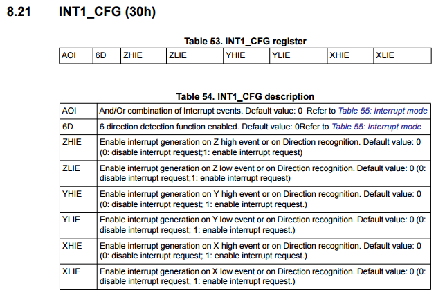

First of all to enable all three axis the value of CTRL_REG1 must be 0x27.
Than you configuration of
INT1_CFG = 0x7F is not correct, basically you set the interrupt to be triggered if the acceleration is below or higher than threshold in any axis so this is always true.
So you should configure to enable interrupt only if the acceleration is higher than threshold, please be aware absolute value is evaluated, so it doesn't matter if the value is positive or negative.
You should also enable the high pass filter, because there will be always 1g of gravitation which would trigger the interrupt. The high pass filter will also omit any offset.

INT1_CFG = 0x2A //OR, X,Y,Z higher than threshold
