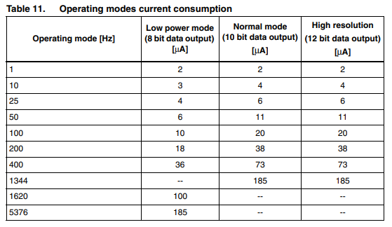

I'm using the LIS2DH at a 10 Hz sample rate and need to change it to 400 Hz. How will this change power consumption of the device?

you can find the detailed table of the LIS2DH power consumption in the datasheet, p.17:
In your case, depending on your mode, you can have the following power consumption variations:
  • Low power mode --> from 3uA [10Hz] to 36uA [400Hz]
  • Normal mode --> from 4uA [10Hz] to 73uA [400Hz]
  • High resolution mode --> from 4uA [10Hz] to 73uA [400Hz]
Let me please know if it is enough for your scope.
