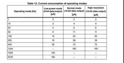

The LIS2DH12, in LP ODR 10Hz and FS 2G, should have a current consumption of about 3uA, accordingly to datasheet:

At 8 bit it is 3uA, but we need to get 10bit values. Therefore it will be 4 according to the datasheet.

2024-04-30 4:18 AM
Hi @Emiel ,
The values on the datasheet are at Vdd=1.8V, we expect that as Vdd increases, current consumption will increase.
Your configuration is fine to have a low power consumption, as shown in the table.

Hi @Emiel ,
For LIS2DH12, a current consumption of about 5uA is expected in LP mode, Vdd=3.6 and ODR 10Hz.
For LIS2DU12, when ODR=12.5Hz, LP Mode and FS=2g and Vdd=3.6V we expect about the same values of LIS2DH12.
