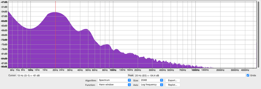

 In the following the signal recorded again in anechoic chamber.

I forgot to attach the recording in the anechoic chamber.
