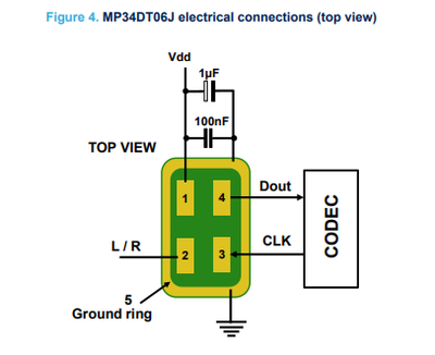

just to check: did you set the connections between Vdd and GND as in the figure 4 of the datasheet?

I see some issues in the schematic:
you put 100 nF and 10 uF from Vdd to GND, while the recommended is 100 nF and 1 uF
also, the 10k R from LR to GND should not be useful
I'm not sure if the reason for your problem can be that, but maybe you can also keep track of the Vdd line to check if the mic is powered up or not during operations
