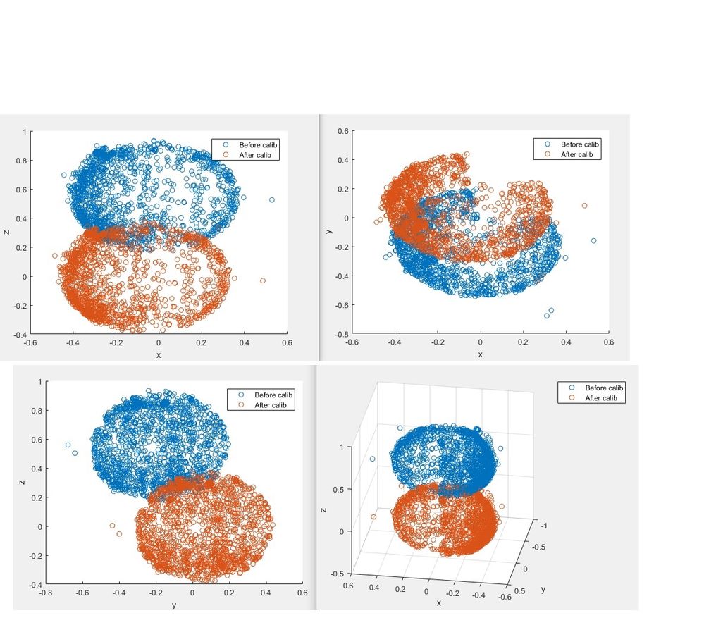

2020-12-16 9:07 AM
Hello Eleon,
I am doing calibration by rotating the device in 3D and collecting raw data(mag_raw)
Then raw data is converted to Gauss by using formula mag_Gauss(x,y,z) = mag_raw(x,y,z)*1.5/1000.
max_x = max of all values in mag_Gauss_x
max_y= max of all values in mag_Gauss_y
max_z = max of all values in mag_Gauss_z
min_x = min of all values in mag_Gauss_x
min_y = min of all values in mag_Gauss_y
min_z = min of all values in mag_Gauss_z
Then compensated value calculated by using below equations
mag_x = mag_Gauss_x-(max_x + min_x)/2
mag_y = mag_Gauss_y-(max_y + min_y)/2
mag_z = mag_Gauss_z-(max_z + min_z)/2
But I thing data is not properly calibrated since elliptic nature is there.
Results and raw data attached
Regards,
GBiswal

Hi GBiswal @GBISW.1 ,
the elliptic shape of the magnetic data plots are denoting the presence of soft iron distortion, so the simple "offset" compensation is not so effective as desired.
For this kind of compensation, you should first check if you have any source of unwanted magnetic fields around your application platform, and then use more complex algorithms, such as for example the MotionMC magnetometer calibration library form the X-CUBE-MEMS1 firmware function pack.
"The library acquires data from the magnetometer and calculates the hard iron (HI) and soft iron (SI) coefficients or, in the case of the library for Cortex-M3 and M4, only the scale factor (SF - diagonal elements of soft iron matrix) coefficients together with the calibration quality value. The calibration coefficients are then used to compensate raw data from the magnetometer and reduce hard iron and soft iron effects."
-Eleon
