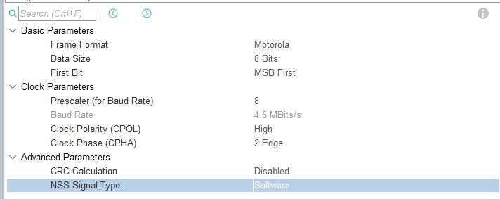

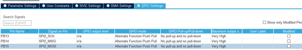

I have set up the STM32's SPI with STM32CubeIDE, with settings shown below:

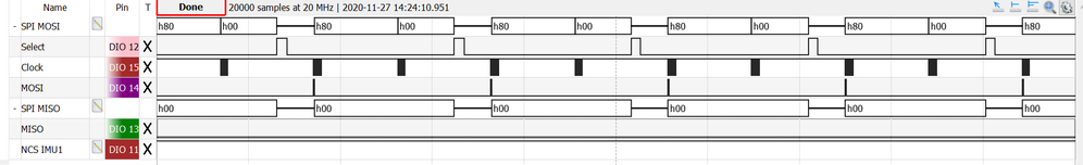

}When i look at the signals with a logic analyzer i see the following:
Nice and clean communication from the STM32, writing two bytes, first being address (Who am i 0x00 + readbit) and the second being empty, as it expects to receive data.
