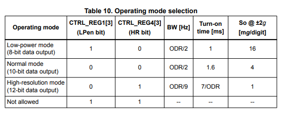

Just for checking, which ODR did you set in reg CTRL_REG1 (20h)? You have to format the data according to this table. Regards

I set the configuration registers as the procedure states. CTRL_REG1 is set to 47h, which sets an ODR of 50Hz. I also made sure to wait the stated time to allow for powering up and stabilization, in addition to discarding the first samples.
The tests I had previously done never gave reasonable results. Even when placing the accelerometer at rest and as flat as possible, I never got to measure anywhere close to 1g in any of the axes. As a matter of fact, when using it in the ±2g range, I always measured samples around the 25k mark (I mean the 16-bit integer from joining both the high and low bytes), which corresponds to more than 1g (~25/32 * 2g = 1,5g).
